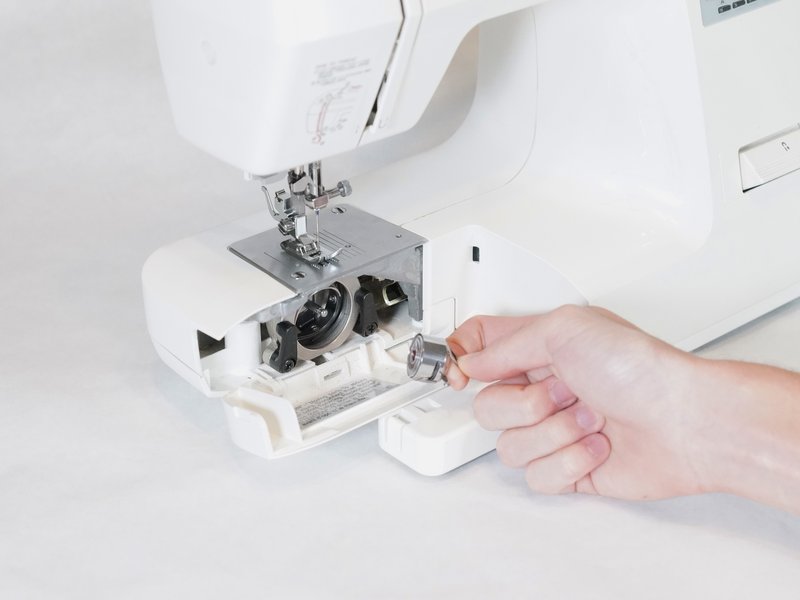

    1. Brother XR-40 Bobbin Replacement, Bobbin: step 1, image 1 of 2 Brother XR-40 Bobbin Replacement, Bobbin: step 1, image 2 of 2
      • Pull off the storage area beneath the needle.
      Ask FixBot
    2. Brother XR-40 Bobbin Replacement: step 2, image 1 of 1
      • Flip open the tab below the needle.
      Ask FixBot
    3. Brother XR-40 Bobbin Replacement: step 3, image 1 of 2 Brother XR-40 Bobbin Replacement: step 3, image 2 of 2
      • Pull on the end of the rectangular tab on the bobbin case. This will pop off the bobbin and bobbin case.
      Ask FixBot
    4. Brother XR-40 Bobbin Replacement: step 4, image 1 of 1
      • Pull the bobbin out of the bobbin case.
      Ask FixBot
