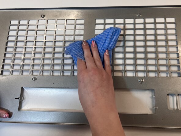

    5. Broan PM250 Exhaust Fan Filter Replacement: step 5, image 1 of 3 Broan PM250 Exhaust Fan Filter Replacement: step 5, image 2 of 3 Broan PM250 Exhaust Fan Filter Replacement: step 5, image 3 of 3
      • Using a mild detergent, clean the housing both inside and out. Be sure to clean the fan blades as well.
