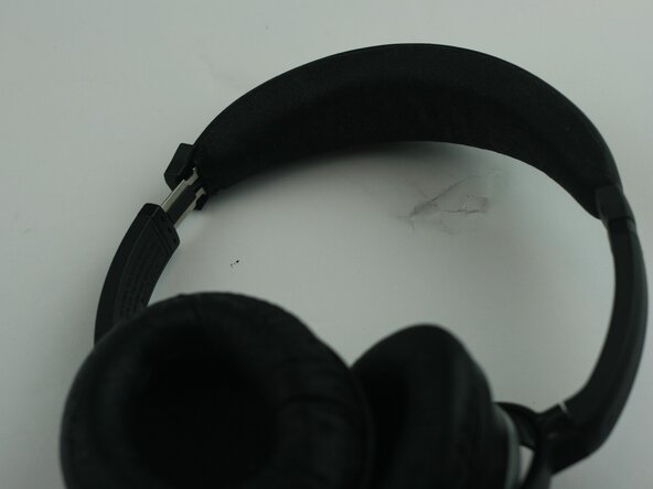

    • Identify the worn headband padding.
    • Remove the two 2.0mm Phillips #00 screws securing the headband assembly on each side.
    • Do not use excessive force, as it can damage the plastic underneath.
    • Good lighting can help you see how the padding is attached.

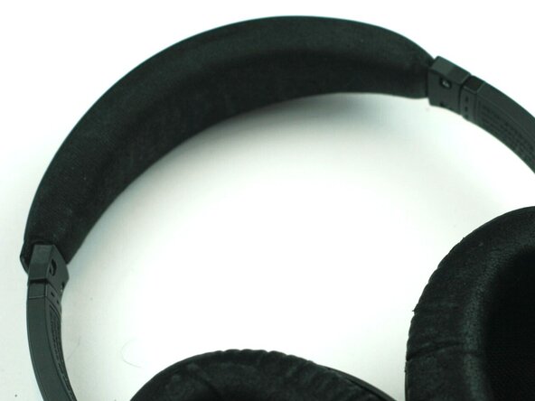

  2. Bose QuietComfort 15 Headband Padding Replacement: step 2, image 1 of 3 Bose QuietComfort 15 Headband Padding Replacement: step 2, image 2 of 3 Bose QuietComfort 15 Headband Padding Replacement: step 2, image 3 of 3
    • Use rubbing alcohol and a paper towel to remove leftover adhesive.
    • Wipe away dust and debris.
    • Ensure the surface is smooth and dry.
    • Use a pair of scissors in order to remove the old headband padding.
    • A clean surface helps the new padding stick properly.
