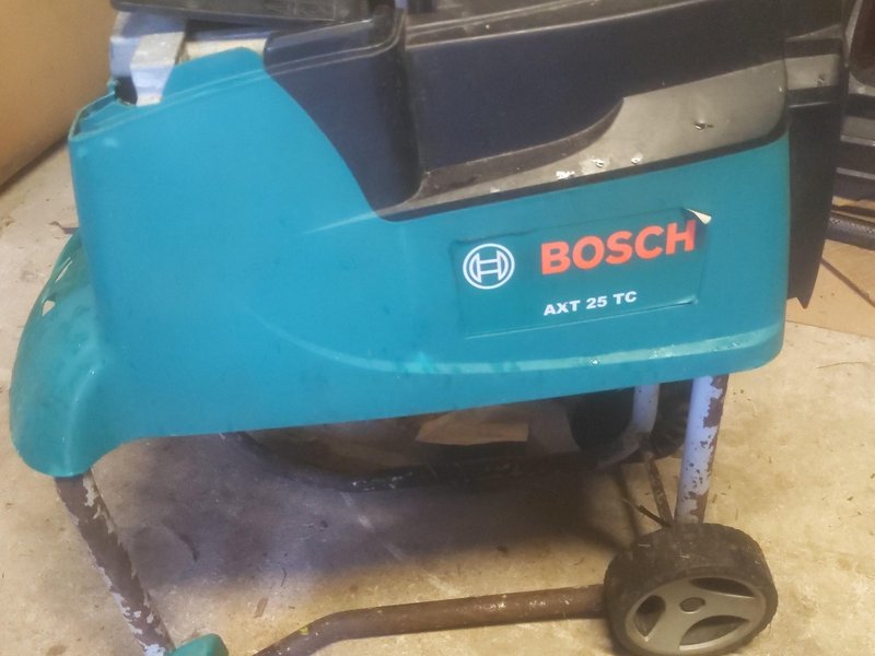

This tutorial aims to help you disassemble, and possibly repair, your Bosch AXT 25 TC garden shredder.
Many models are very similar to this shredder (AXT 25 D / 22D / 2550 / ...). Many of the steps may be the same.

    1. Bosch planetary gear disassembly, Disassembly Preparation: step 1, image 1 of 1
      • To prepare for the disassembly of this shredder, you must begin by:
      • Removing the collection bin (see user manual)
      • Removing the upper funnel (also known as the chute). The manual can also assist you here.
      • These steps are the standard storage procedures for the shredder.
