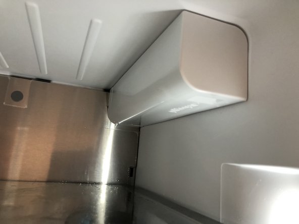

    • The water filter panel is at the top right of the refrigerator. Ensure that the area around the water filter panel is clear.
    • On the bottom of the panel, there is a small directional arrow. Gently pull the panel towards you to unlock the panel.
    • Once the panel has unlocked, the door hinges towards the bottom left. Open the door to reveal the water filter.
    • The panel door remains attached and is a hinged design.

    • Ensure that the newly purchased water filter matches the existing filter before proceeding to next steps.
    Ask FixBot
  7. Bosch B36CL80SNS Water Filter Replacement: step 7, image 1 of 3 Bosch B36CL80SNS Water Filter Replacement: step 7, image 2 of 3 Bosch B36CL80SNS Water Filter Replacement: step 7, image 3 of 3
    • Gently rotate the water filter counterclockwise to unlock the existing water filter.
    • Once the water filter is unlocked, pull the filter towards you to remove it.

  8. Bosch B36CL80SNS Water Filter Replacement: step 8, image 1 of 1
    • Install the new water filter. There are small tabs on the filter housing which line up to the water filter inlet.
    • Gently rotate the new water filter clockwise to lock the filter into place.
    • Caution: The refrigerator will automatically pressurize the new filter. Ensure that the new filter is secured. Failure to properly secure the filter can dislodge the filter when pressurized.
