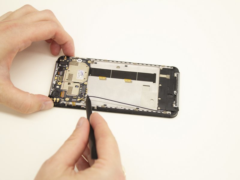

    1. Blu Grand M Motherboard Replacement, Motherboard: step 7, image 1 of 2 Blu Grand M Motherboard Replacement, Motherboard: step 7, image 2 of 2
      • Place a spudger or other tool underneath the black wire.
      • Lift up on the gold coaxial cable connector so it disconnects from the motherboard.
      Ask FixBot
