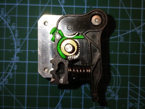

    4. Blocked extruder, Removing the stepper motor: step 4, image 1 of 2 Blocked extruder, Removing the stepper motor: step 4, image 2 of 2
      • As you can see in the first image you can see your source of the clogging.
      • (Move to image 2) Gently lift the the stepper motor upwards, you should be able to feel a tug on the bottom. That should be the filament. Cut it down at much as you can and gently push in into the extruder a tiny bit. Then, unplug the stepper motor and place in onto your clean, dry workbench.
      Ask FixBot
    5. Blocked extruder, Removing the clog: step 5, image 1 of 3 Blocked extruder, Removing the clog: step 5, image 2 of 3 Blocked extruder, Removing the clog: step 5, image 3 of 3
      • (First + Scecond image) Remove the screw on the top right using a small hex-key or screwdriver and disassemble, be careful not lose the screw or spring.
      • (Third Image) Remove as much filament as you buy do not try to force anything that won't move, I'll come back for that in the next step.
      • Be careful not to damage the mechanism or teeth of the servo motor gear.
      Ask FixBot
    6. Blocked extruder, Removing stuck clog: step 6, image 1 of 2 Blocked extruder, Removing stuck clog: step 6, image 2 of 2
      • (First image) If the filament is still stuck and wont move unscrew the screw on the bottom right of the image again with a screwdriver or hex-key. If the clog is cleaned go to the next step.
      • Unscrewing this will remove the black cover and any filament you cannot reach will pop out.
      Ask FixBot
