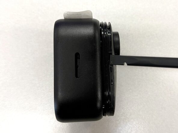

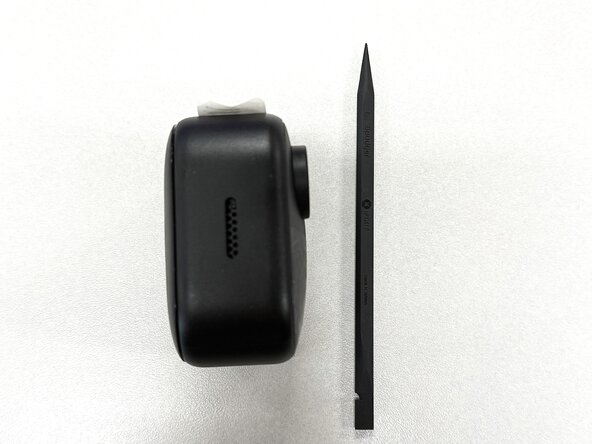

    2. Blink Outdoor 4 Motherboard Replacement: step 2, image 1 of 2 Blink Outdoor 4 Motherboard Replacement: step 2, image 2 of 2

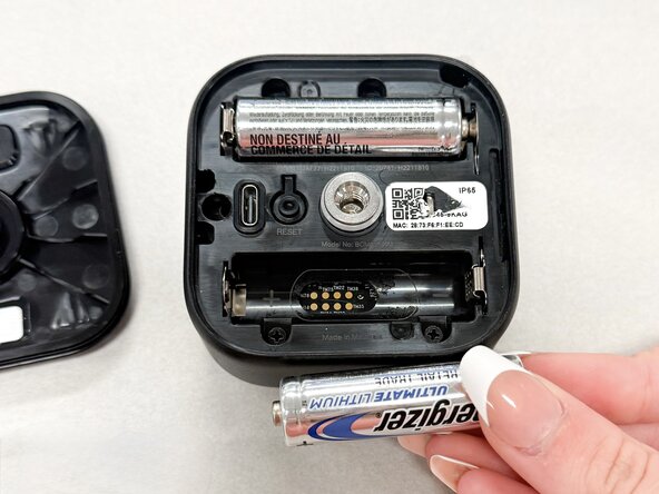

      • Insert a spudger between the back casing and the device, then gently pry the casing loose.
      • Remove the two AA batteries and set them aside.

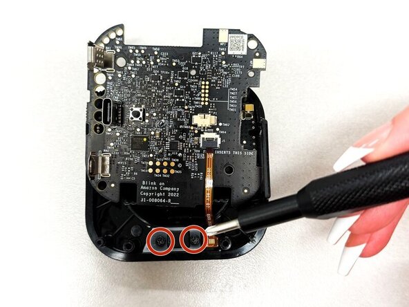

    3. Blink Outdoor 4 Motherboard Replacement: step 3, image 1 of 2 Blink Outdoor 4 Motherboard Replacement: step 3, image 2 of 2
      • Use a Phillips #1 screwdriver to remove four screws near the battery compartments.
      • Make sure to keep track of the screws for reassembly.
