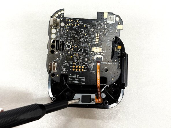

    6. Blink Outdoor 4 Microphone Replacement: step 6, image 1 of 3 Blink Outdoor 4 Microphone Replacement: step 6, image 2 of 3 Blink Outdoor 4 Microphone Replacement: step 6, image 3 of 3
      • Gently lift the motherboard out of the device by its edges.
      • Do not pull on the board as it's attached to cables from underneath, and could damage the device.
      • Place the motherboard on top of the base of the device, as pictured, to make the next steps easier to access.
      • Use a Phillips #0 screwdriver to remove two screws from the white bracket.
      Ask FixBot
    7. Blink Outdoor 4 Microphone Replacement: step 7, image 1 of 3 Blink Outdoor 4 Microphone Replacement: step 7, image 2 of 3 Blink Outdoor 4 Microphone Replacement: step 7, image 3 of 3
      • Remove the black and then the white covering at the bottom.
      • Save the two pieces to reattach when replaced.
      • Use a spudger or a clean fingernail to flip up the black locking flap—this is the unlocked position.
      • Use the widest tool possible to avoid damaging the delicate hinge pins.
      • Gently pull the orange microphone cable out of its motherboard socket using tweezers or your fingers to remove the microphone.
