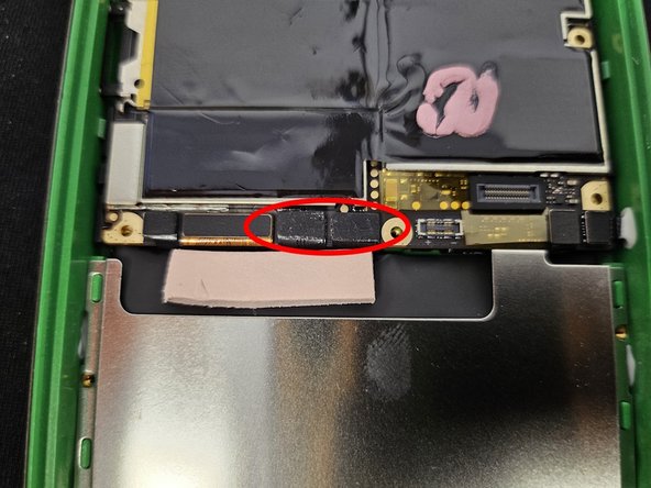

  6. Blackview BV9200: Motherboard Replacement, Removing peripherals off the motherboard: step 7, image 1 of 1
    • Remove the connectors, the cameras and the screws that are pointed to.
    • Tweezers or plastic cards work well for removing connectors here.

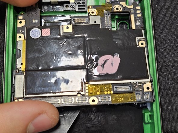

  7. Blackview BV9200: Motherboard Replacement, Removing the motherboard from the case: step 8, image 1 of 3 Blackview BV9200: Motherboard Replacement, Removing the motherboard from the case: step 8, image 2 of 3 Blackview BV9200: Motherboard Replacement, Removing the motherboard from the case: step 8, image 3 of 3
    • The motherboard assembly is held in place by 2 latches. Get it unlatched.
    • Once you have it unlatched, pull it slightly towards you, then bend it over so you can see the underside.
    • Disconnect the data cable.
    • Be careful when doing this, as these cables are fragile and it is very easy to tear their heads off.
