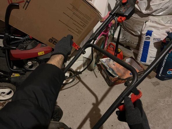

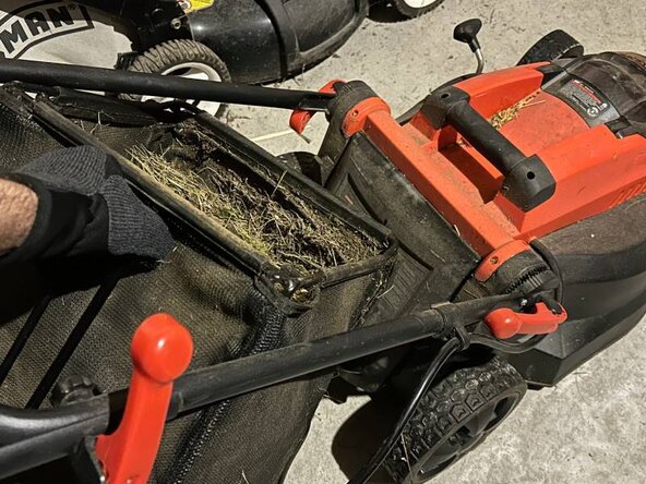

    2. Black and Decker CM1640 Blade Replacement: step 2, image 1 of 3 Black and Decker CM1640 Blade Replacement: step 2, image 2 of 3 Black and Decker CM1640 Blade Replacement: step 2, image 3 of 3
      • Remove the grass bag and fold the handles.
