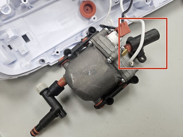

    6. Bissell PowerFresh Steam Valve Replacement: step 8, image 1 of 1
      • Use a Phillips #2 screwdriver to remove the four 14 mm screws securing the pump.
      • Remove the two 14mm PH2 screws securing the valve.
      Ask FixBot
    7. Bissell PowerFresh Steam Valve Replacement: step 9, image 1 of 1
      • Lift the heater with the valve at a slight angle and pull it out of the mop body.
      Ask FixBot
    8. Bissell PowerFresh Steam Valve Replacement: step 10, image 1 of 1
      • Pull the valve from the heater to remove it.
      Ask FixBot
