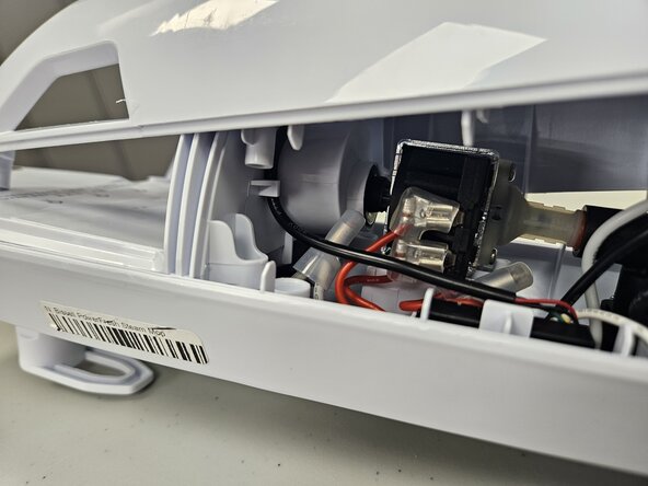

    4. Bissell PowerFresh Steam Mop Pump Replacement: step 6, image 1 of 2 Bissell PowerFresh Steam Mop Pump Replacement: step 6, image 2 of 2
      • Insert an opening tool into the seam between the front and back sections. Slide it around the perimeter to release the clips securing the casing.
      • Gently separate them.
      • You may hear clicking or popping as they separate.
      • There is a cable connected to the front cover, so be careful when separating.
      • Use a Phillips #2 screwdriver to remove two 14 mm screws from inside the unit.

    5. Bissell PowerFresh Steam Mop Pump Replacement: step 7, image 1 of 3 Bissell PowerFresh Steam Mop Pump Replacement: step 7, image 2 of 3 Bissell PowerFresh Steam Mop Pump Replacement: step 7, image 3 of 3
      • Pull the pump off the unit.
      • Gently wiggle the connectors side to side to loosen them, then pull them straight off.
