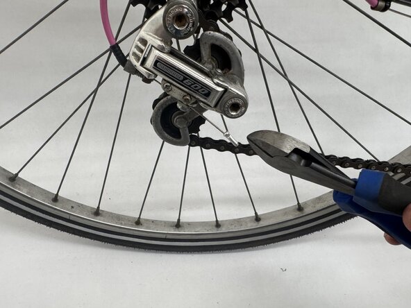

    2. Bicycle Rear Shifting Cable Replacement: step 2, image 1 of 2 Bicycle Rear Shifting Cable Replacement: step 2, image 2 of 2
      • Using the pair of dykes, cut the old cable end off of the old cable.
      • Use caution, the dykes are sharp!

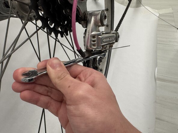

      • Make note of how the cable is secured by the cable securing bolt on the derailleur.
      • Using the 9mm wrench, loosen the cable securing bolt on the rear derailleur.
      • The bolt does not need to be removed entirely, only loosened enough to remove the cable.
      Ask FixBot
    4. Bicycle Rear Shifting Cable Replacement: step 4, image 1 of 3 Bicycle Rear Shifting Cable Replacement: step 4, image 2 of 3 Bicycle Rear Shifting Cable Replacement: step 4, image 3 of 3
      • Remove the cable from the securing bolt.
      • Make note of how the cable is routed through the bike.
      • Remove the old cable from the bike by pulling the cable away from the rear derailleur (toward the front wheel).

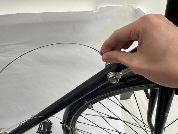

      • Remove the old cable from the shifter cable eye by pushing the cable up from below.
      • Pull the old cable up until it is completely removed from the shifter.
      Ask FixBot

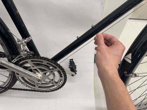

      • Install the new cable into the shifter by threading it into the shifter cable eye.
      • Pull the new cable completely through until the cable end is resting in the shifter's cable eye.
      • Route the new cable back through the bicycle the same way the old cable was routed.

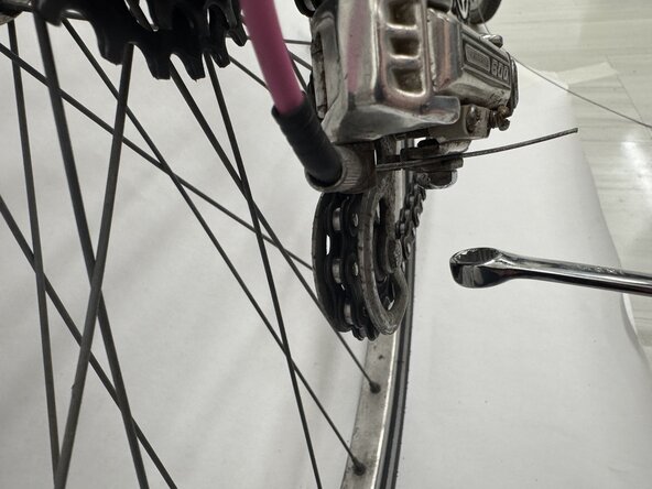

      • Reinstall the cable housing in its guides if necessary and guide the cable through the rear derailleur cable eye.
      • Pull the cable through completely.
      • Ensure the cable is installed correctly underneath the cable securing bolt on the derailleur. It should be in the same place the old cable was secured.

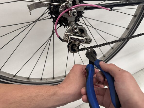

      • Use the pair of dykes to cut the new cable, leaving about an inch and a half of extra cable beyond the cable securing bolt.
      • Use caution when using the dykes, they are sharp!
