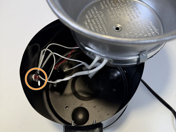

      • Remove the silver lining from the black casing.
      • Detach the bulb from the device.

    5. Bella 1.5 QT Slow Cooker Disassembly: step 5, image 1 of 3 Bella 1.5 QT Slow Cooker Disassembly: step 5, image 2 of 3 Bella 1.5 QT Slow Cooker Disassembly: step 5, image 3 of 3
      • Remove the bottom from the outer casing.

    6. Bella 1.5 QT Slow Cooker Disassembly: step 6, image 1 of 3 Bella 1.5 QT Slow Cooker Disassembly: step 6, image 2 of 3 Bella 1.5 QT Slow Cooker Disassembly: step 6, image 3 of 3
      • Loosen the metal clamps.
      • The final image shows the position the switch should be in while in the off position.

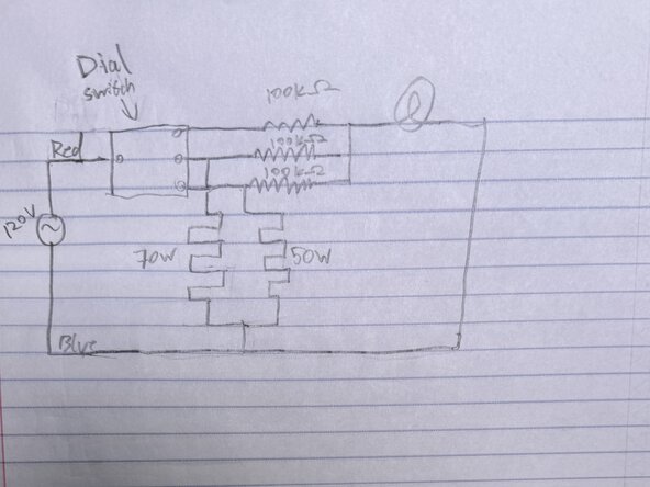

      • Here are some final images of the disassembled slow cooker that focuses on the heating element and the circuit.
      • The text boxed on the device reads: "1.5qt 120V 120 70 50W." The 120W 70W 50W refers to the power in cooking modes high, low, and warm, respectively.
      • The final image is a hand-drawn schematic of the electrical circuitry of the slow cooker.
