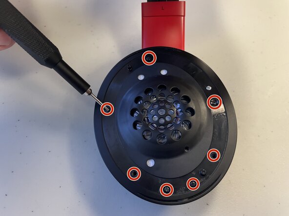

    2. Beats Studio3 Wireless Bluetooth Board Replacement: step 2, image 1 of 2 Beats Studio3 Wireless Bluetooth Board Replacement: step 2, image 2 of 2
      • Unscrew all seven 5.2mm screws with a Phillips #00 screwdriver.
      • Pull the plastic face off.

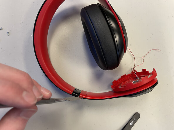

    10. Beats Studio3 Wireless Bluetooth Board Replacement: step 10, image 1 of 2 Beats Studio3 Wireless Bluetooth Board Replacement: step 10, image 2 of 2
      • Pry the plastic piece with the L written on it off the headband using a spudger.
      Ask FixBot

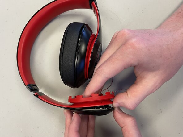

    11. Beats Studio3 Wireless Bluetooth Board Replacement: step 11, image 1 of 3 Beats Studio3 Wireless Bluetooth Board Replacement: step 11, image 2 of 3 Beats Studio3 Wireless Bluetooth Board Replacement: step 11, image 3 of 3
      • Pry and slide the red rubber piece down off the headphone using your hands revealing the black bluetooth board.
      Ask FixBot

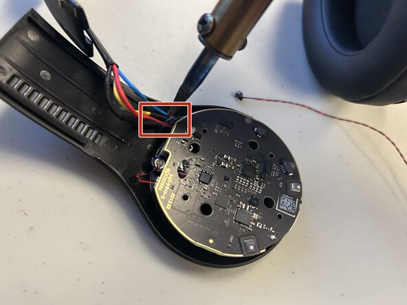

    20. Beats Studio3 Wireless Bluetooth Board Replacement: step 20, image 1 of 2 Beats Studio3 Wireless Bluetooth Board Replacement: step 20, image 2 of 2
      • Desolder the remaining wires.
      • Pull all of the wires off the bluetooth board.
      Ask FixBot
