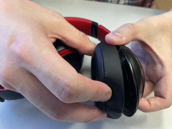

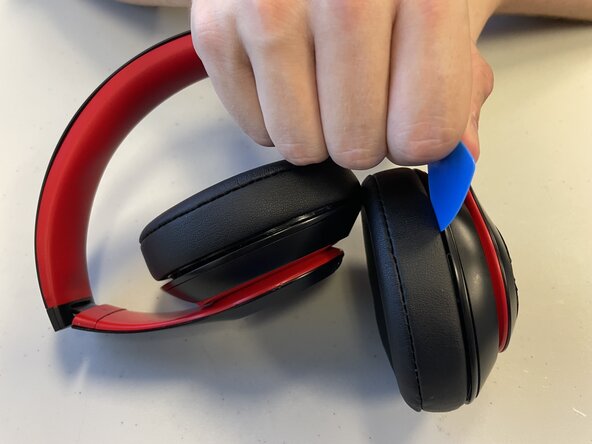

    • Insert an opening pick into the seam between the left driver housing and the left ear pad.
    • Apply pressure until the two begin to seperate.
    • Pull them apart until the ear pad is fully removed from the headset.

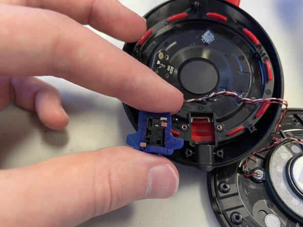

  4. Beats Studio3 Wireless Auxilary Port Replacement: step 4, image 1 of 3 Beats Studio3 Wireless Auxilary Port Replacement: step 4, image 2 of 3 Beats Studio3 Wireless Auxilary Port Replacement: step 4, image 3 of 3
    • Insert a spudger underneath the auxiliary port.
    • Apply gentle pressure pressing up around the auxiliary port until it pops free.
