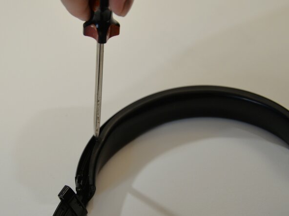

      • Close the headphone for access to the screw heads.
      • Take out both screws from the left side and right side.

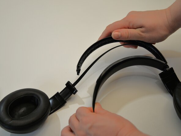

      • Flip open the headphones.
      • Pull the headband out of the speaker hinge buckle.
      • Beware there is an internal audio cable connecting the speakers. Be careful not to break the cable.

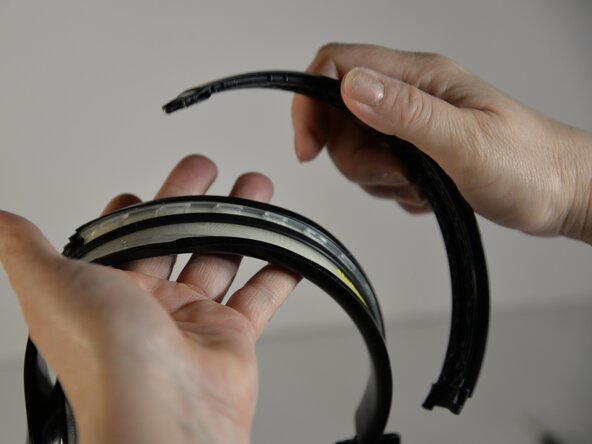

      • Pry the upper and lower headband apart.
