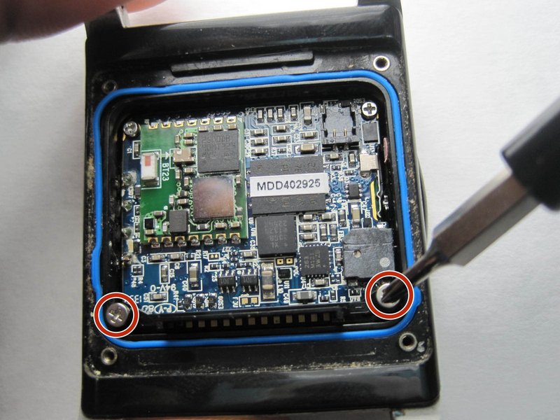

    2. Basis B1 Band LED Screen Replacement: step 8, image 1 of 1
      • Use PH000 tool to remove two 4mm screws.
      Ask FixBot
