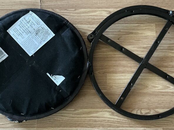

Barstool Seat Cushion Replacement

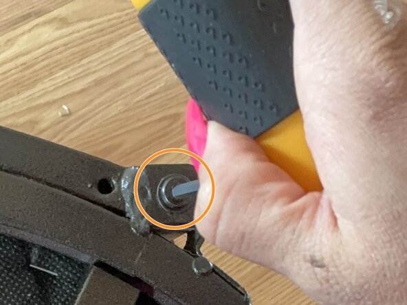

    1. Barstool Seat Cushion Replacement, Barstool Seat Cushion: step 1, image 1 of 3 Barstool Seat Cushion Replacement, Barstool Seat Cushion: step 1, image 2 of 3 Barstool Seat Cushion Replacement, Barstool Seat Cushion: step 1, image 3 of 3
      • Remove the four hex screws under the barstool using an Allen wrench.
      • If your stool has a backrest, remove it by unscrewing the two hex screws with an Allen wrench.
      Ask FixBot

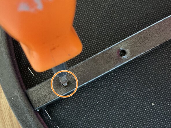

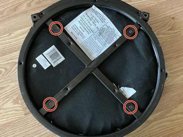

    2. Barstool Seat Cushion Replacement: step 2, image 1 of 3 Barstool Seat Cushion Replacement: step 2, image 2 of 3 Barstool Seat Cushion Replacement: step 2, image 3 of 3
      • Remove the four Phillips screws.
      • Grab and lift the metal frame and push the seat out at the same time.
      Ask FixBot

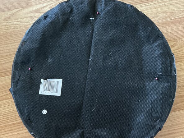

    3. Barstool Seat Cushion Replacement: step 3, image 1 of 3 Barstool Seat Cushion Replacement: step 3, image 2 of 3 Barstool Seat Cushion Replacement: step 3, image 3 of 3
      • Remove the staples around the bottom of the stool.
      • Lift the bottom fabric off.
      • You can save or replace the bottom fabric.
      • Remove any remaining staples.
