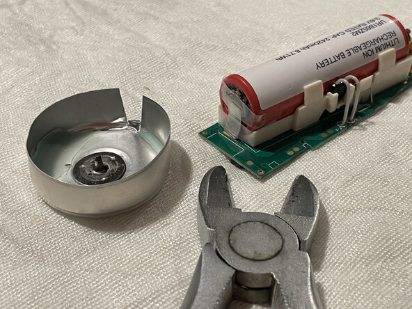

  7. Babyliss E986E Battery Replacement, Remove old battery: step 7, image 1 of 1
    • The battery is held down with tape and 2 metal plates soldered to the PCB and the battery.
    • Remove the metal plates as best as you can, it doesn't matter too much if you cut them off or damage them as it's easy to make new ones.
    • Remove the old battery.
    Ask FixBot
  8. Babyliss E986E Battery Replacement, Insert new battery and make contact: step 8, image 1 of 2 Babyliss E986E Battery Replacement, Insert new battery and make contact: step 8, image 2 of 2
    • Place the new battery, if you kept the original metal tabs intact, then make sure they make contact and secure them with electrical tape.
    • If you damaged the old tabs, I cut part of an old candle to make a new metal tab on the positive side of the battery and stuck it in place with tape (electrical tape is better).
