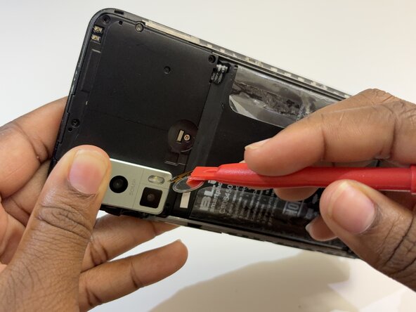

    4. BLU S91 Pro Phone Battery Replacement: step 4, image 1 of 3 BLU S91 Pro Phone Battery Replacement: step 4, image 2 of 3 BLU S91 Pro Phone Battery Replacement: step 4, image 3 of 3
      • Use the pry tool to carefully lift the fingerprint sensor and expose the screw underneath.
