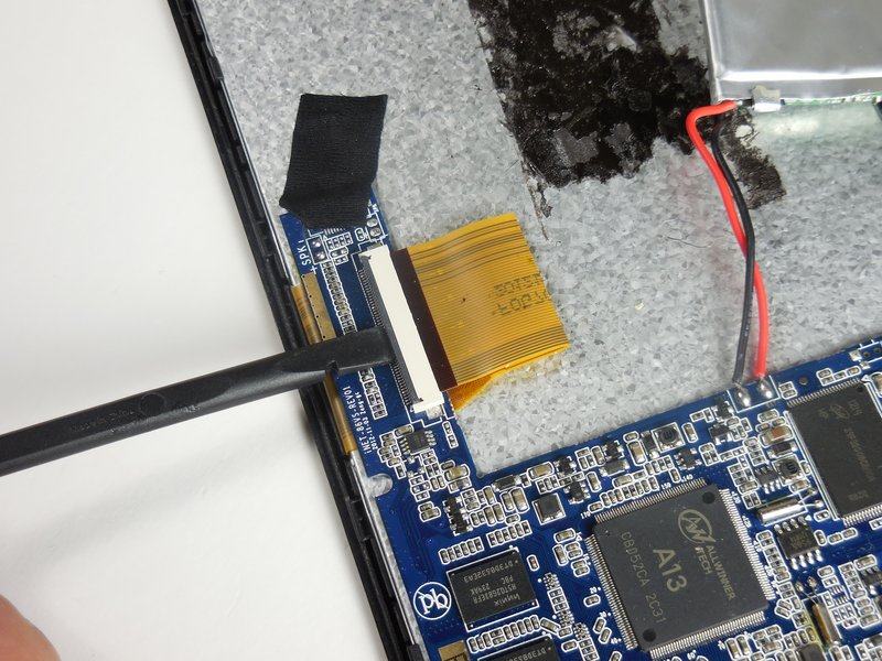

    1. Azpen A701 Screen Replacement, Screen: step 5, image 1 of 3 Azpen A701 Screen Replacement, Screen: step 5, image 2 of 3 Azpen A701 Screen Replacement, Screen: step 5, image 3 of 3
      • Disconnect the two largest (of the three) ZIF cables by prying open the flap with a plastic spudger to gently remove them.
