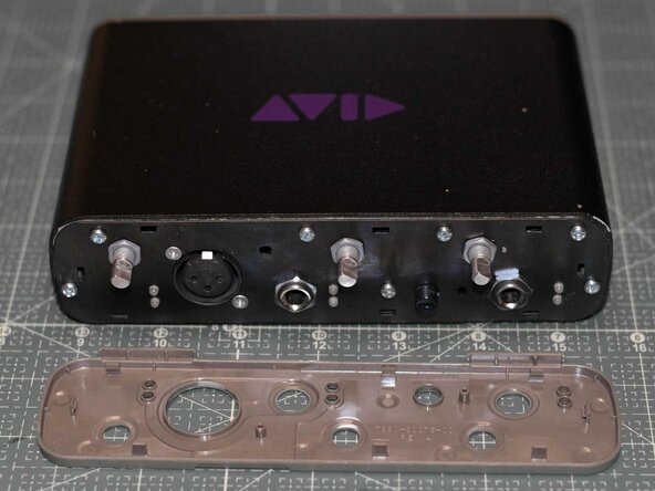

    3. Avid Fast Track Solo Potentiometer Cleaning, Open the front cover: step 3, image 1 of 3 Avid Fast Track Solo Potentiometer Cleaning, Open the front cover: step 3, image 2 of 3 Avid Fast Track Solo Potentiometer Cleaning, Open the front cover: step 3, image 3 of 3
      • Turn the unit upside down.
      • Insert an iFixit pick in the ridge between the body and the front plate, start in front of the feet pads and work around the unit.
      • Carefully pry of the front plate.

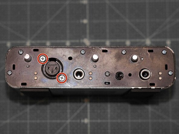

    5. Avid Fast Track Solo Potentiometer Cleaning, Unscrew screws: step 5, image 1 of 2 Avid Fast Track Solo Potentiometer Cleaning, Unscrew screws: step 5, image 2 of 2
      • Unscrew all the screws fitted on the front plate, in the following order:
      • Use a PH1 screwdriver to remove the two PH1 screws securing the XLR jack.
      • Use a PH2 screwdriver to remove the remaining PH2 screws securing the front metal plate to the chassis.
