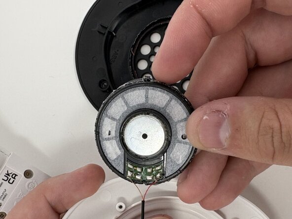

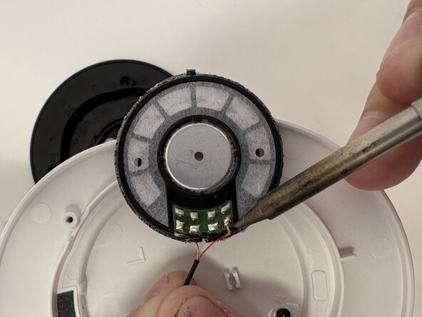

    1. Audio-Technica ATH-M20xBT Driver Replacement, Driver: step 5, image 1 of 1
      • Use a hairdryer or heat gun to gently warm the adhesive securing the driver.
      • Be patient and ensure that you don't overheat the area.
      Ask FixBot
    2. Audio-Technica ATH-M20xBT Driver Replacement: step 6, image 1 of 3 Audio-Technica ATH-M20xBT Driver Replacement: step 6, image 2 of 3 Audio-Technica ATH-M20xBT Driver Replacement: step 6, image 3 of 3
      • Use an opening tool to gently pry up the driver from its housing.
      • Be aware of the hinge on the side across from the green circuit board.
      Ask FixBot
    3. Audio-Technica ATH-M20xBT Driver Replacement: step 7, image 1 of 1
      Ask FixBot
