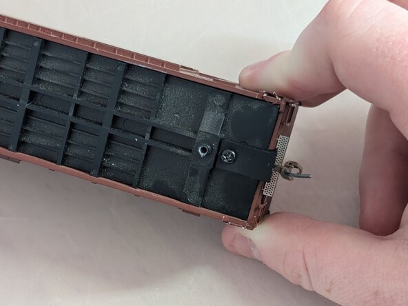

    1. Athearn Ready To Roll Coupler Replacement, Athearn Ready To Roll Coupler: step 1, image 1 of 3 Athearn Ready To Roll Coupler Replacement, Athearn Ready To Roll Coupler: step 1, image 2 of 3 Athearn Ready To Roll Coupler Replacement, Athearn Ready To Roll Coupler: step 1, image 3 of 3
      • Flip the railcar upside down so the bottom is facing up.
      • Use a Phillips #0 screwdriver to remove the 4.3 mm screw that holds the truck in place.
      • Remove the truck from the bottom of the train.

    2. Athearn Ready To Roll Coupler Replacement: step 2, image 1 of 3 Athearn Ready To Roll Coupler Replacement: step 2, image 2 of 3 Athearn Ready To Roll Coupler Replacement: step 2, image 3 of 3
      • Use a Phillips #0 screwdriver to remove the 4.3 mm screw from the coupler housing from the frame.
      • Remove the coupler housing.
