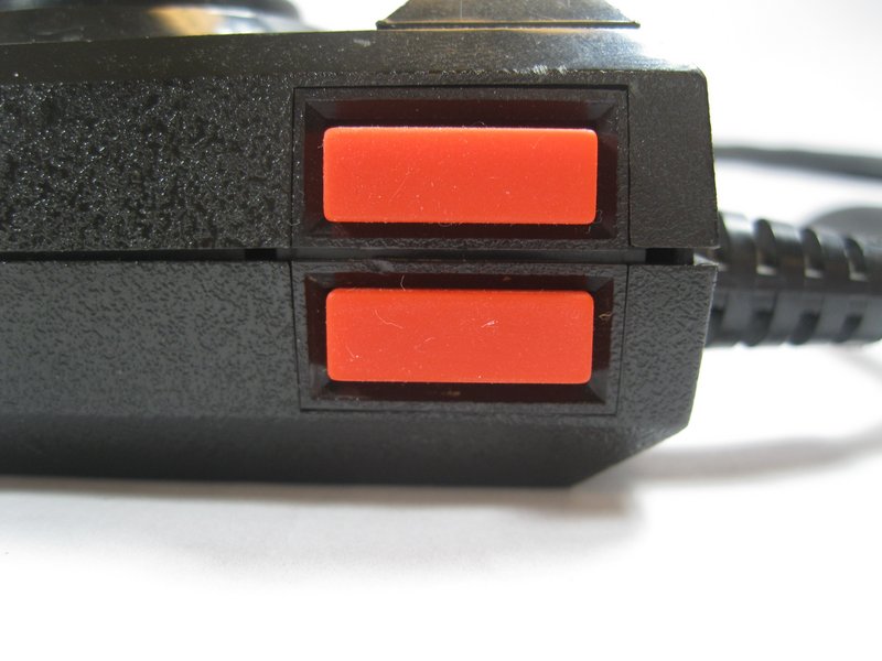

    1. Atari 5200 Controller Side Buttons Replacement, Controller Side Buttons: step 1, image 1 of 3 Atari 5200 Controller Side Buttons Replacement, Controller Side Buttons: step 1, image 2 of 3 Atari 5200 Controller Side Buttons Replacement, Controller Side Buttons: step 1, image 3 of 3
      • Turn the controller over, exposing the three screws on the back. Use a 6mm screwdriver to remove these screws.
      • Carefully slide and pull the two parts of the controller shell apart, exposing the innards.
      Ask FixBot
    2. Atari 5200 Controller Side Buttons Replacement, A Little Off the Sides: step 2, image 1 of 2 Atari 5200 Controller Side Buttons Replacement, A Little Off the Sides: step 2, image 2 of 2
      • Now that the top of the controller is exposed, the orange, side buttons can easily slide out.
      • Realign the buttons over the sensors/clean the sensor contacts.
      • Be careful when reassembling your buttons. Make sure the black buttons are aligned properly over the silver sensors on the flex board
      • Also, be careful to properly align the bottom of the joystick with the pots (white levers)
