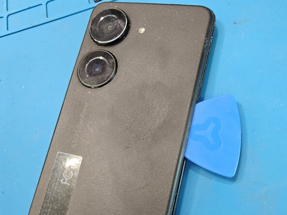

    2. Asus Zenfone 10 Battery Replacement, Remove back cover: step 2, image 1 of 2 Asus Zenfone 10 Battery Replacement, Remove back cover: step 2, image 2 of 2
      • Using an heat gun, warm the adhesive around the edges of the back cover to soften it.
      • Run an opening pick around the edge of the phone to separate the back cover from the phone.

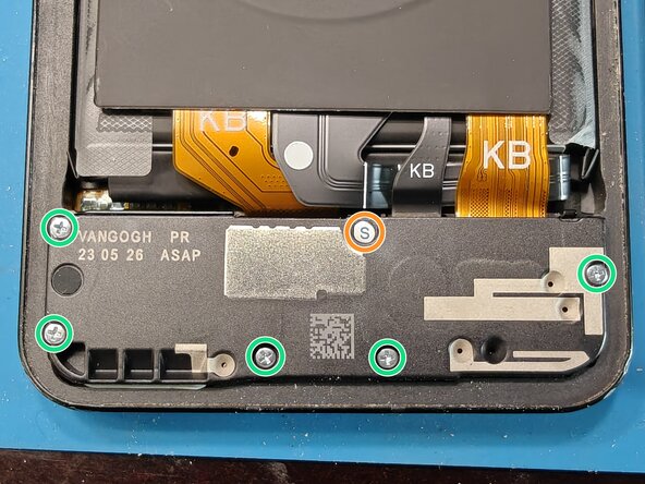

    4. Asus Zenfone 10 Battery Replacement, Remove bottom cover: step 4, image 1 of 3 Asus Zenfone 10 Battery Replacement, Remove bottom cover: step 4, image 2 of 3 Asus Zenfone 10 Battery Replacement, Remove bottom cover: step 4, image 3 of 3
      • Use a Phillips #000 Screwdriver or a bit to remove the six highlighted screws.
      • The screw highlighted in orange has a decal on top of it which you can easily remove with a sharp instrument like flathead screwdriver bit.

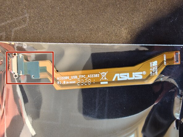

    6. Asus Zenfone 10 Battery Replacement, Replace the USB-C port: step 6, image 1 of 2 Asus Zenfone 10 Battery Replacement, Replace the USB-C port: step 6, image 2 of 2
      • Detach the flat cable from the case to free the USB-C port.
      • Heat the flat cable to help loosen the adhesive if it feels stuck.
      • Insert the new part where the old one was.
      • Make sure to peel off the blue film covering the adhesive before installing the new cable.

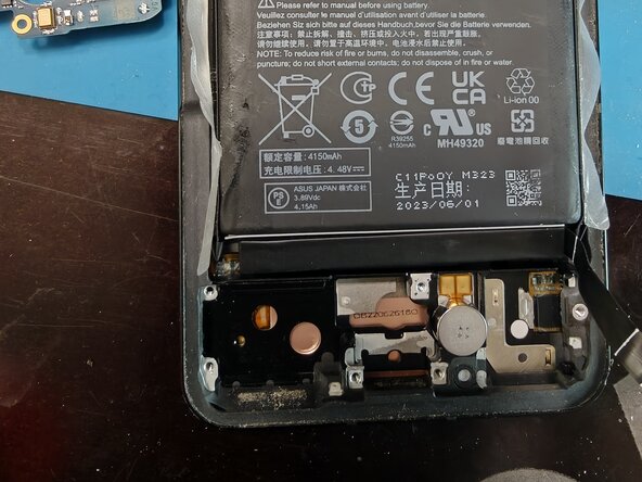

    1. Asus Zenfone 10 Battery Replacement, Replace the battery: step 7, image 1 of 2 Asus Zenfone 10 Battery Replacement, Replace the battery: step 7, image 2 of 2
      • Follow the Asus Zenfone 10 USB-C Charging Port Replacement -guide to the step 5.
      • Gently bend the charging port cable away from the working area.
      • Disconnect the battery cable.
      • To make the battery easier to remove, apply a small amount of IPA along the perimeter to weaken the adhesive bond. Use a plastic prying tool to carefully lift and extract the battery.
      • You'll need to use some force here, but take care not to pierce the battery when prying it out.
      • Remove the old adhesive from the case with IPA and plastic prying tool.
      • Add a new adhesive between the new battery and case.
      • Install the new battery and connect the cable.
