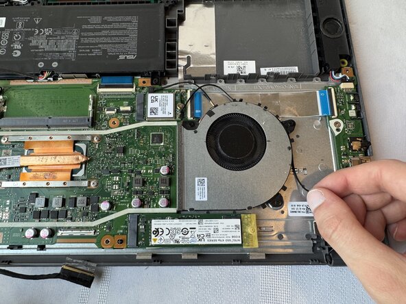

    7. Asus X515EA-BB53-CB LCD Screen Replacement: step 7, image 1 of 3 Asus X515EA-BB53-CB LCD Screen Replacement: step 7, image 2 of 3 Asus X515EA-BB53-CB LCD Screen Replacement: step 7, image 3 of 3
      • Use tweezers to gently peel back the adhesive tape securing the LCD cable to the motherboard.
      • Pull the LCD cable away from its port to disconnect it.
      Ask FixBot

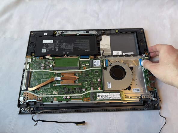

    8. Asus X515EA-BB53-CB LCD Screen Replacement: step 8, image 1 of 2 Asus X515EA-BB53-CB LCD Screen Replacement: step 8, image 2 of 2
      • Unroute the Wi-Fi cable from around the cooling fan.
      • Lift up on the Wi-Fi cable to disconnect it from its port.
      • The Wi-Fi cable may be difficult to connect during reassembly; ensure the wire is properly routed with enough slack to move the end towards its port.
      Ask FixBot

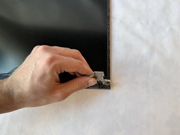

    9. Asus X515EA-BB53-CB LCD Screen Replacement: step 9, image 1 of 3 Asus X515EA-BB53-CB LCD Screen Replacement: step 9, image 2 of 3 Asus X515EA-BB53-CB LCD Screen Replacement: step 9, image 3 of 3
      • Remove six silver 5mm screws from the hinges using a Phillips #1 screwdriver.
      • One screw has a metal ring surrounding it. This ring is connected to the LCD cable.
      • Pull both hinges away from the motherboard until they are at a 90° angle in relation to the laptop base.
      • Make note of which screw this ring was attached to; be sure to put the ring on the screw before reassembly.

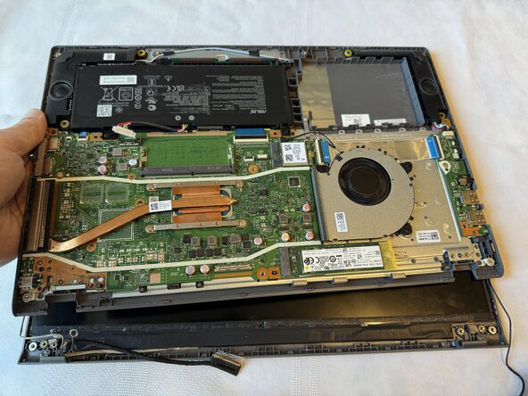

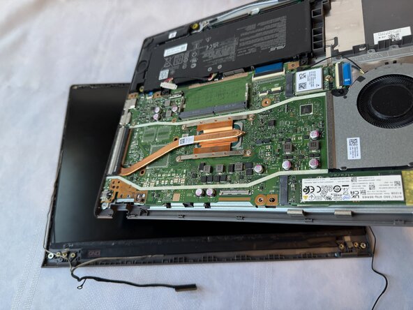

    10. Asus X515EA-BB53-CB LCD Screen Replacement: step 10, image 1 of 3 Asus X515EA-BB53-CB LCD Screen Replacement: step 10, image 2 of 3 Asus X515EA-BB53-CB LCD Screen Replacement: step 10, image 3 of 3
      • Lift and remove the main laptop base away from the screen assembly, and set the base aside.
      Ask FixBot

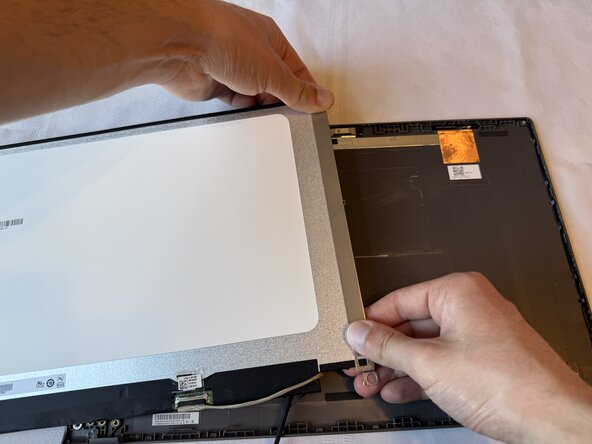

    13. Asus X515EA-BB53-CB LCD Screen Replacement: step 13, image 1 of 3 Asus X515EA-BB53-CB LCD Screen Replacement: step 13, image 2 of 3 Asus X515EA-BB53-CB LCD Screen Replacement: step 13, image 3 of 3
      • Lift and remove the hinges that were previously unscrewed.
      • Carefully lift the LCD screen out of the back plate.
      • Flip and lay LCD screen face-down to reveal the LCD cable and its port, the 30-pin connector on the back of the laptop

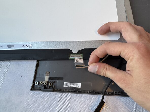

    14. Asus X515EA-BB53-CB LCD Screen Replacement: step 14, image 1 of 3 Asus X515EA-BB53-CB LCD Screen Replacement: step 14, image 2 of 3 Asus X515EA-BB53-CB LCD Screen Replacement: step 14, image 3 of 3
      • Lift the tape securing the LCD cable to the bracket using tweezers.
      • Disconnect the LCD cable by pulling it away from the panel.

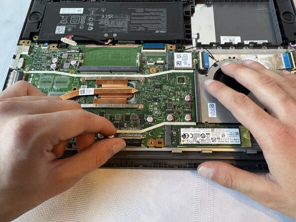

    17. Asus X515EA-BB53-CB LCD Screen Replacement: step 17, image 1 of 3 Asus X515EA-BB53-CB LCD Screen Replacement: step 17, image 2 of 3 Asus X515EA-BB53-CB LCD Screen Replacement: step 17, image 3 of 3
      • Place the base of the laptop back on top of the screen assembly, ensuring that the hinges align and the internals are facing upwards.
      • Plug the black LCD cable into the motherboard by pressing it gently into its port.
      • Pull the tape on the connector taut and press it down on the motherboard to ensure connection.

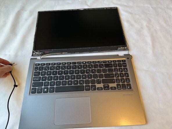

      • Carefully flip the laptop so the keyboard and screen are visible and the internals are facing downwards.
      Ask FixBot

      • In order to prepare the LCD for reassembly, flip the base of the laptop back on top of the screen assembly, ensuring that the internals are facing upwards.
      • Locate the black LCD cable that was reconnected to the motherboard; it will be removed so that the brackets can be installed on the new LCD.
