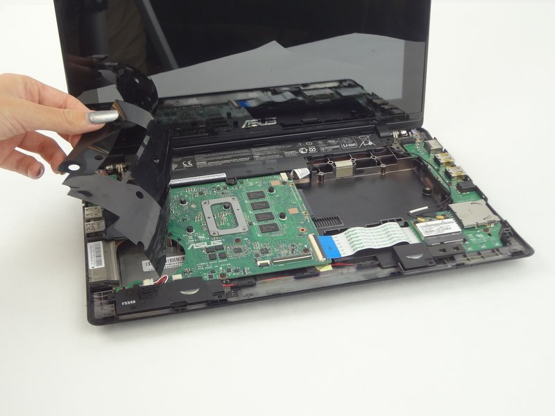

    1. Asus X200CA Motherboard and RAM Replacement, Motherboard and RAM: step 4, image 1 of 1
      • Remove the black plastic cover.
      Ask FixBot
