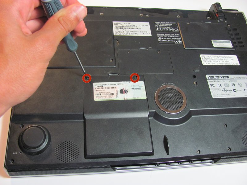

    1. Asus W2W-A1 Hard Drive Replacement, Hard Drive: step 1, image 1 of 1
      • Before disassembly, make sure the laptop is powered off and the battery is disconnected.
      • Remove the two screws (size?) on the lower panel at the bottom of the laptop (identify tool to use).
