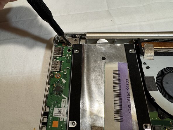

    2. Asus VivoBook S14 Screen Replacement: step 3, image 1 of 2 Asus VivoBook S14 Screen Replacement: step 3, image 2 of 2
      • Using a Phillips screwdriver to remove the screws securing each of the two hinges.

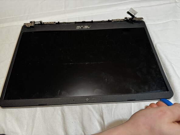

    7. Asus VivoBook S14 Screen Replacement: step 8, image 1 of 3 Asus VivoBook S14 Screen Replacement: step 8, image 2 of 3 Asus VivoBook S14 Screen Replacement: step 8, image 3 of 3
      • To separate the bezel, insert the opening tool into the seam between the screen and the frame.
      • Slide the opening tool along the perimeter while applying a gentle twisting motion to pop the internal plastic clips.
      • Caution: If the bottom edge feels stuck, don't yank it. Check for internal plastic clips.
