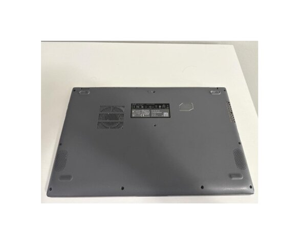

      • Set the laptop upside down on a static free surface (no carpets).
      Ask FixBot
    3. Asus VivoBook M515D RAM Upgrade/Replacement: step 3, image 1 of 2 Asus VivoBook M515D RAM Upgrade/Replacement: step 3, image 2 of 2
      • Remove the 10 visible screws at the bottom of the laptop using a Phillips #0 screwdriver
      Ask FixBot

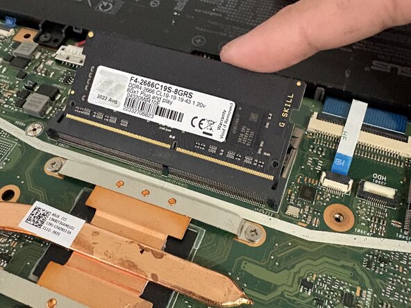

    5. Asus VivoBook M515D RAM Upgrade/Replacement: step 5, image 1 of 1
      • Locate the ram module and gently push the retaining clips outward.
      Ask FixBot
    6. Asus VivoBook M515D RAM Upgrade/Replacement: step 6, image 1 of 1
      • The RAM module will pop out at an angle. Carefully slide the module out of its socket.
      Ask FixBot
    7. Asus VivoBook M515D RAM Upgrade/Replacement: step 7, image 1 of 2 Asus VivoBook M515D RAM Upgrade/Replacement: step 7, image 2 of 2
      • Insert the new ram module into the slot at a 30 degree angle
      Ask FixBot
    8. Asus VivoBook M515D RAM Upgrade/Replacement: step 8, image 1 of 1
      • Gently press down until the retaining clips snap into place.
