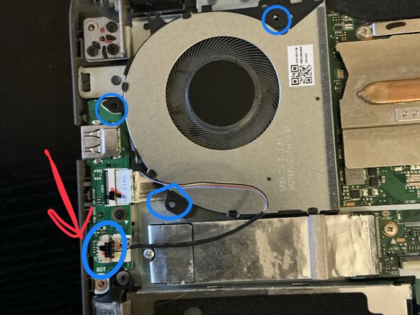

Asus VivoBook 14" F412DA Cooling Fan Replacement
    1. Asus VivoBook 14" F412DA Cooling Fan Replacement, Cooling Fan: step 1, image 1 of 1
      • Open up by removing (4) 9mm screws on the top row and center.
      • Remove (2) 8mm screws on the 2 middle outside screws.
      • Remove (4) 6mm screws on the bottom half.
      Ask FixBot
    2. Asus VivoBook 14" F412DA Cooling Fan Replacement, Fan Removal: step 2, image 1 of 1
      • Remove those 3 screws as circled and unplug connector.
      Ask FixBot
    3. Asus VivoBook 14" F412DA Cooling Fan Replacement, Fan Instal: step 3, image 1 of 1
      • Reconnect connector
      • Screw back in the 3 screws.
      Ask FixBot
    4. Asus VivoBook 14" F412DA Cooling Fan Replacement: step 4, image 1 of 1
      • Close back up
