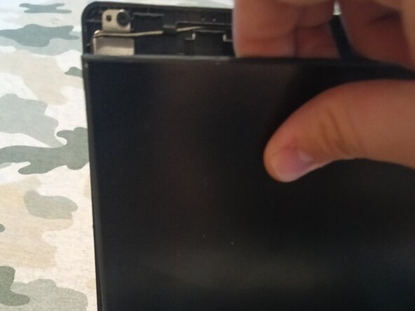

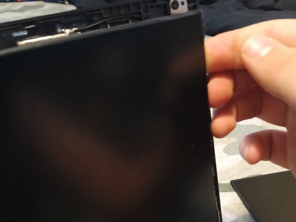

      • This screen does not have an easy way to be removed - The screen is held in place by some form of double-sided sticky tape, and doesn't have a way to be removed prior to removing the screen.
      • Using a prying tool or your hands, carefully remove the screen off of the metal supporting brackets.
      • The green boxes represent the double-sided sticky tape area. It's best to remove this old double-sided tape, and prepare some new double-sided tape to put in place.

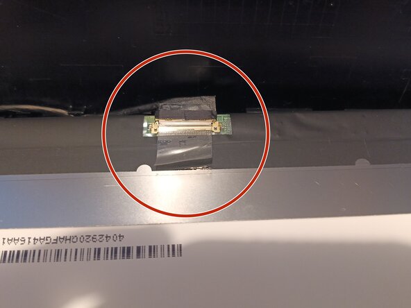

      • The red circle represents the area where the connecter is on the screen. Peel up on the connecter tape, and carefully disconnect the screen.
      • With the new screen, connect it to the device and press the connecter tape down onto the screen. If needed, place a piece of non-conductive tape (for example, Kapton tape) over the connecter.
