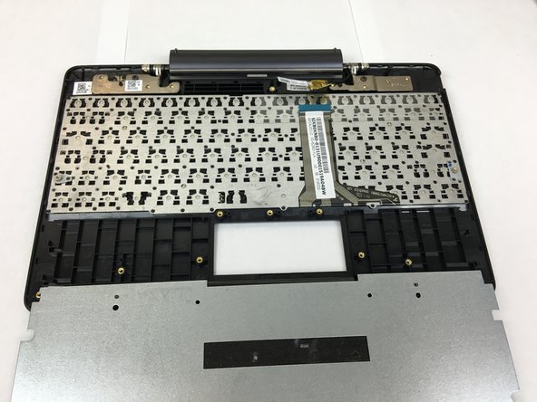

  4. Asus Transformer Book T100TAF Touchpad Replacement: step 4, image 1 of 3 Asus Transformer Book T100TAF Touchpad Replacement: step 4, image 2 of 3 Asus Transformer Book T100TAF Touchpad Replacement: step 4, image 3 of 3
    • Remove the back cover.
    • Use a Phillips #00 screwdriver to remove all the screws from the metal, inside panel, including four black 4.0 mm screws along the top.
    • Remove four black 3.0 screws along the bottom.
    • Remove the one silver 5.0 mm screw in the top right corner.
    Ask FixBot
  5. Asus Transformer Book T100TAF Touchpad Replacement: step 5, image 1 of 1
    • Remove the metal keyboard cover from the device.
    Ask FixBot
