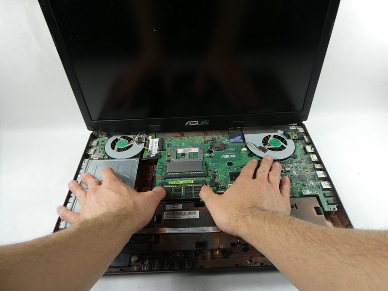

    1. Asus ROG G750JH-DB71 RAM Replacement, RAM: step 10, image 1 of 2 Asus ROG G750JH-DB71 RAM Replacement, RAM: step 10, image 2 of 2
      • The RAM module is located directly in the center of the computer on top of the motherboard.
      • Push in the two levers on each side of the RAM module. This frees the module from the slot and allows removal.
      • Once loose, pull the RAM module away from the slot at a 45 degree angle as to not damage it.
