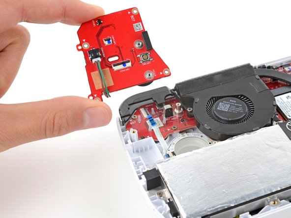

  11. Asus ROG Ally Right Thumbstick Replacement, Unfasten the right thumbstick assembly: step 11, image 1 of 3 Asus ROG Ally Right Thumbstick Replacement, Unfasten the right thumbstick assembly: step 11, image 2 of 3 Asus ROG Ally Right Thumbstick Replacement, Unfasten the right thumbstick assembly: step 11, image 3 of 3
    • Use a Phillips #00 screwdriver to remove the four 3.4 mm‑long screws securing the right thumbstick assembly.
    • During reassembly, keep the left edge of your device lifted while you tighten the screws so the thumbstick doesn't press against your work surface and pop out of place.
    Ask FixBot
  12. Asus ROG Ally Right Thumbstick Replacement, Remove the right thumbstick assembly: step 12, image 1 of 3 Asus ROG Ally Right Thumbstick Replacement, Remove the right thumbstick assembly: step 12, image 2 of 3 Asus ROG Ally Right Thumbstick Replacement, Remove the right thumbstick assembly: step 12, image 3 of 3
    • Insert the flat end of a spudger between the bottom left edge of the thumbstick assembly and the chassis.
    • Pry up the thumbstick assembly and remove it.
    • During reassembly:
    • Orient the board over your device thumbstick side down.
    • Thread the thumbstick ring cable through its cutout on the board.
    • Lift the left edge of your device and push the thumbstick assembly firmly into place so the small circular cutouts on the left edge go over their alignment posts. The board should stay firmly in place.
    Ask FixBot
