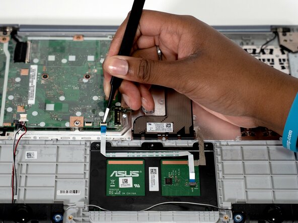

    1. Asus L406M Touchpad Replacement, Touchpad: step 7, image 1 of 2 Asus L406M Touchpad Replacement, Touchpad: step 7, image 2 of 2
      • Use tweezers to flip up the black locking flap securing the touchpad ribbon cable to its motherboard socket.
      • Disconnect the ribbon cable

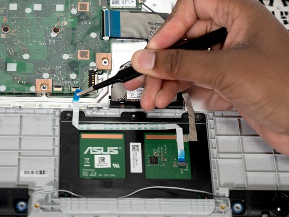

    2. Asus L406M Touchpad Replacement: step 8, image 1 of 2 Asus L406M Touchpad Replacement: step 8, image 2 of 2
      • Use a Phillips #00 screwdriver to remove three 2.4 mm-long screws securing the touchpad.
      • The screws in the photo strange because they were stripped. Stripped screws are caused by using the wrong tool, over-tightening the screws, or corrosion. If your screws are stripped, try using screw extracting pliers to loosen them before using the screwdriver.
      Ask FixBot

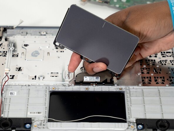

    3. Asus L406M Touchpad Replacement: step 9, image 1 of 2 Asus L406M Touchpad Replacement: step 9, image 2 of 2
      • Gently lift and remove the touchpad.
