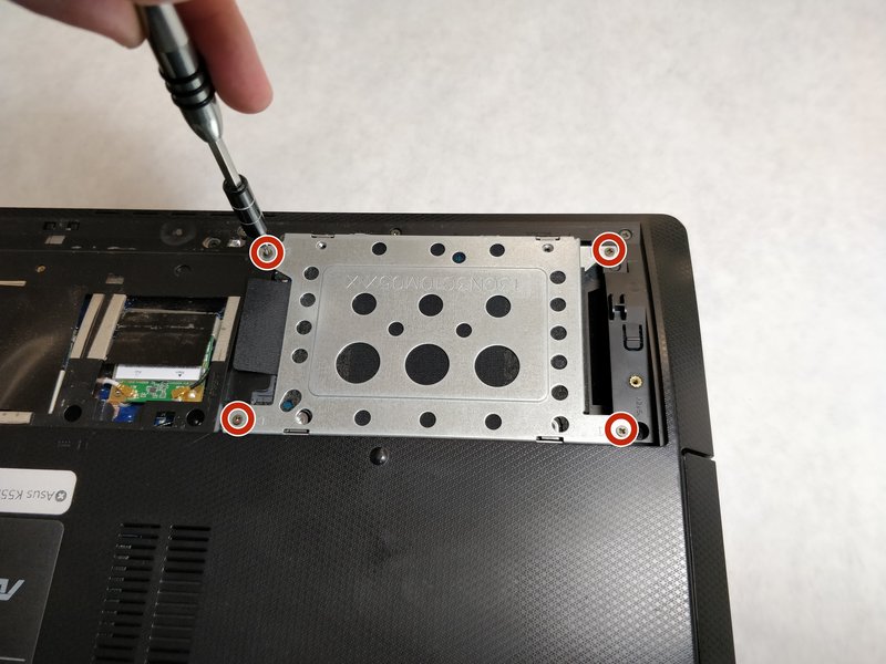

    1. Asus K55N-DS81 Hard Drive Replacement, Hard Drive: step 7, image 1 of 1
      • Using a JIS #00 screwdriver, unscrew the four 5 mm screws fastening the hard drive enclosure to the laptop.
      Ask FixBot
