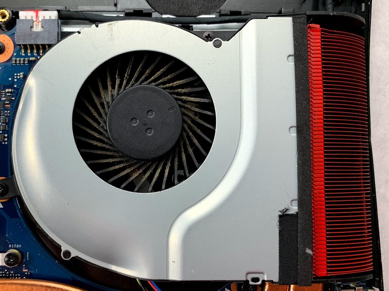

    1. Asus GL551JW-AH71 Fan Replacement, Fan: step 13, image 1 of 1
      • Place the separated motherboard keyboard side down.
      Ask FixBot
    2. Asus GL551JW-AH71 Fan Replacement: step 14, image 1 of 3 Asus GL551JW-AH71 Fan Replacement: step 14, image 2 of 3 Asus GL551JW-AH71 Fan Replacement: step 14, image 3 of 3
      • Unplug the fan connector cable from the motherboard with an iFixit opening tool.
      Ask FixBot
    3. Asus GL551JW-AH71 Fan Replacement: step 15, image 1 of 2 Asus GL551JW-AH71 Fan Replacement: step 15, image 2 of 2
      • With a Phillips #00 screwdriver, remove the three 5mm screws that hold the fan in place.
      Ask FixBot
    4. Asus GL551JW-AH71 Fan Replacement: step 16, image 1 of 2 Asus GL551JW-AH71 Fan Replacement: step 16, image 2 of 2
      • Gently remove the fan from the motherboard.
      Ask FixBot
