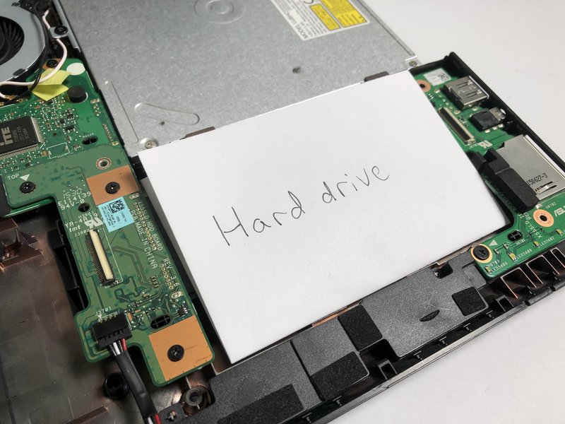

    3. Asus F555LA-AB31 Hard Drive Replacement: step 3, image 1 of 3 Asus F555LA-AB31 Hard Drive Replacement: step 3, image 2 of 3 Asus F555LA-AB31 Hard Drive Replacement: step 3, image 3 of 3
      • Fold the keyboard section of the laptop up towards the screen to fully expose the inside of the device.
      • Unscrew the four 4mm Phillips #0 screws holding down the hard drive.
      Ask FixBot
    4. Asus F555LA-AB31 Hard Drive Replacement: step 4, image 1 of 1
      • Disconnect the ZIF connector and lift the hard drive out of the space.
      Ask FixBot
