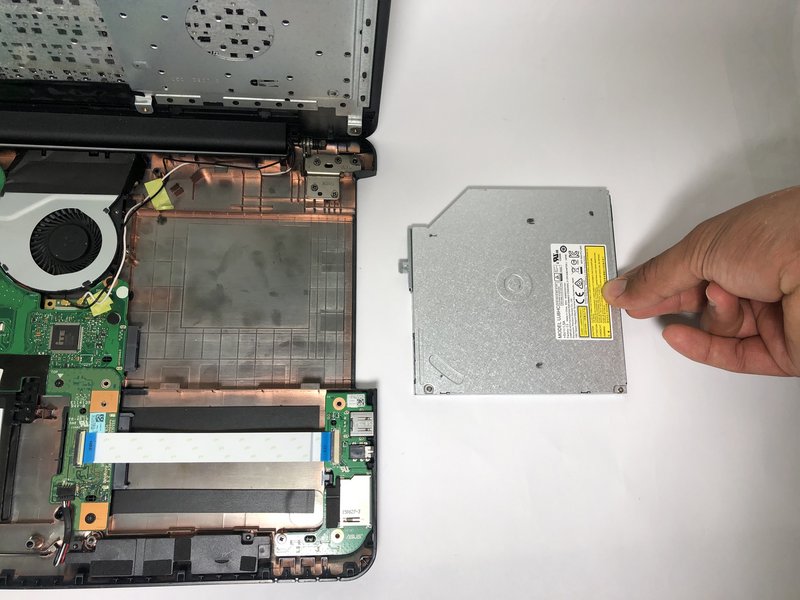

    4. Asus F555LA-AB31 CD Drive Replacement: step 4, image 1 of 2 Asus F555LA-AB31 CD Drive Replacement: step 4, image 2 of 2
      • Use the Phillips #0 screwdriver to unscrew the one Phillips #0 screw that connects the CD drive to the motherboard.
      • Slowly slide out the CD drive, keeping it level, to remove it.
