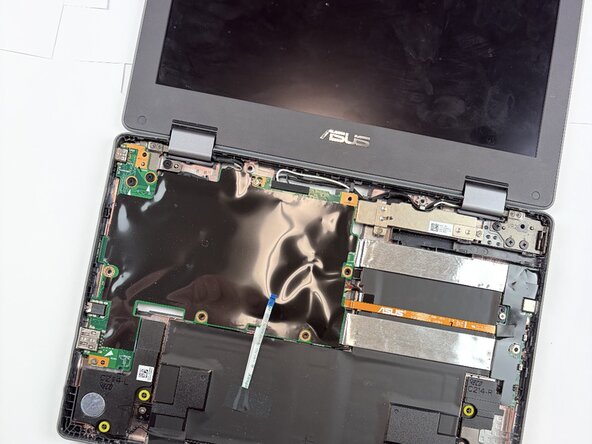

  4. Asus Chromebook Flip C214MA Keyboard Replacement: step 4, image 1 of 2 Asus Chromebook Flip C214MA Keyboard Replacement: step 4, image 2 of 2
    • Remove battery; Slide the locking pin open and remove the battery from the motherboard, using the spudger tool or tweezers

  5. Asus Chromebook Flip C214MA Keyboard Replacement: step 5, image 1 of 2 Asus Chromebook Flip C214MA Keyboard Replacement: step 5, image 2 of 2
    • Remove 4, 5mm screws from the bottom cover panel, using the phillips screwdriver

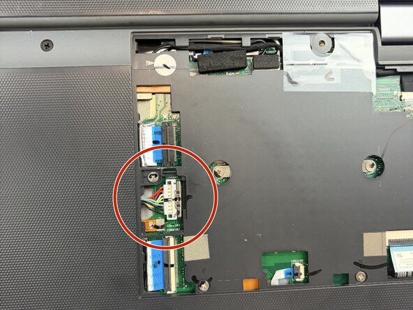

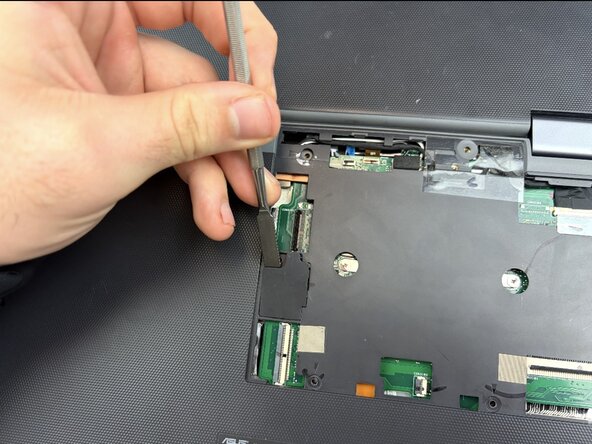

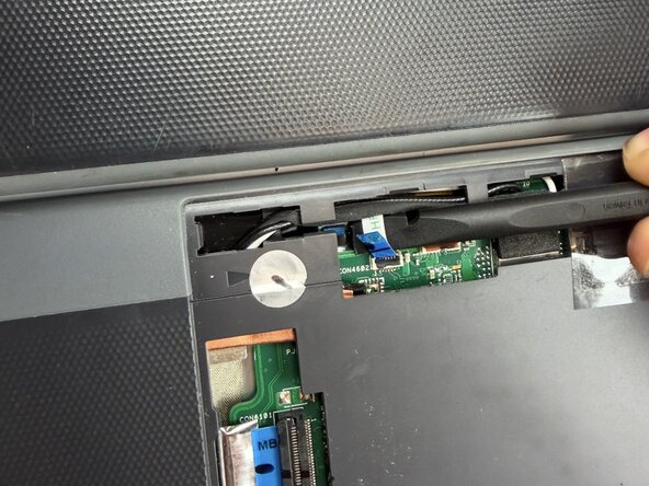

  6. Asus Chromebook Flip C214MA Keyboard Replacement: step 6, image 1 of 3 Asus Chromebook Flip C214MA Keyboard Replacement: step 6, image 2 of 3 Asus Chromebook Flip C214MA Keyboard Replacement: step 6, image 3 of 3
    • Remove the touchpad, microphone, palm rest, camera ribbons, and wifi antennas. Using a spudger and tweezers, pull each ribbon up to disconnect

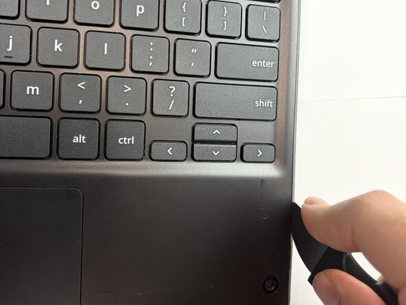

  7. Asus Chromebook Flip C214MA Keyboard Replacement: step 7, image 1 of 3 Asus Chromebook Flip C214MA Keyboard Replacement: step 7, image 2 of 3 Asus Chromebook Flip C214MA Keyboard Replacement: step 7, image 3 of 3
    • Remove the palm rest by flipping the Chromebook over and prying the front palmrest off using a spudger tool
