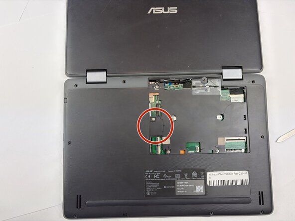

  3. Asus Chromebook Flip C214MA Display Assembly Replacement: step 3, image 1 of 3 Asus Chromebook Flip C214MA Display Assembly Replacement: step 3, image 2 of 3 Asus Chromebook Flip C214MA Display Assembly Replacement: step 3, image 3 of 3
    • Use the spudger to remove the battery connector panel.
    Ask FixBot

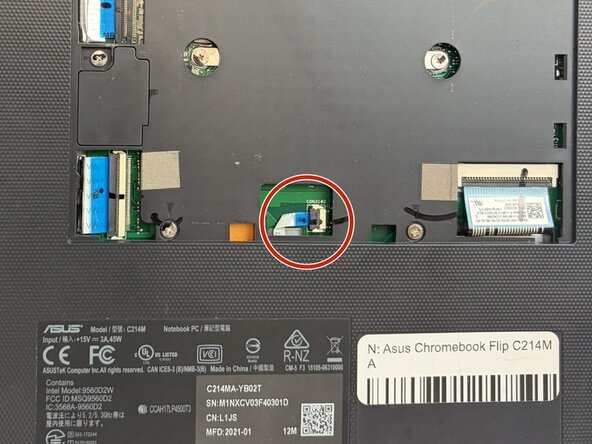

  4. Asus Chromebook Flip C214MA Display Assembly Replacement: step 4, image 1 of 2 Asus Chromebook Flip C214MA Display Assembly Replacement: step 4, image 2 of 2
    • Disconnect the battery cable. Use the tip of a spudger or your fingernail to flip up the small locking flap, then gently pull the cable out of the connector.
    • Do not pull on the wires. Pull from the connector only.

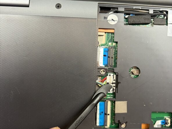

  5. Asus Chromebook Flip C214MA Display Assembly Replacement: step 5, image 1 of 3 Asus Chromebook Flip C214MA Display Assembly Replacement: step 5, image 2 of 3 Asus Chromebook Flip C214MA Display Assembly Replacement: step 5, image 3 of 3
    • Disconnect the keyboard ribbon, touchpad ribbon, microphone ribbon, and camera ribbon. Use the spudger to lift each locking tab before removing the ribbon cables.

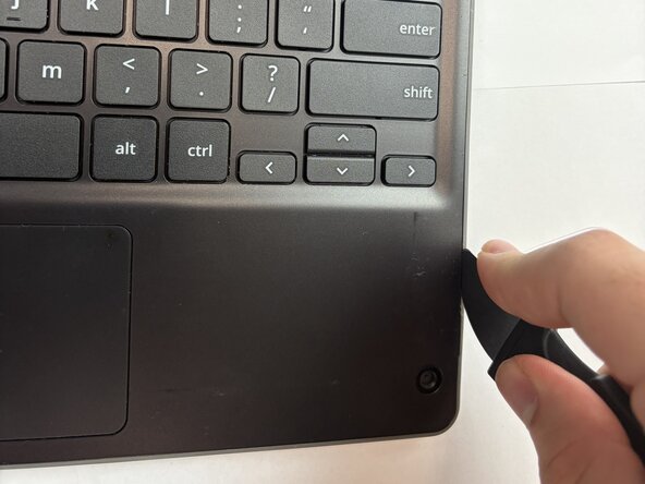

  7. Asus Chromebook Flip C214MA Display Assembly Replacement: step 7, image 1 of 3 Asus Chromebook Flip C214MA Display Assembly Replacement: step 7, image 2 of 3 Asus Chromebook Flip C214MA Display Assembly Replacement: step 7, image 3 of 3
    • Flip the device over and open it. Use a spudger to unclip and remove the palm rest from the bottom cover.

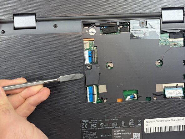

    • Open the back panel using a metal spudger.
    Ask FixBot
  15. Asus Chromebook Flip C214MA Display Assembly Replacement: step 15, image 1 of 3 Asus Chromebook Flip C214MA Display Assembly Replacement: step 15, image 2 of 3 Asus Chromebook Flip C214MA Display Assembly Replacement: step 15, image 3 of 3
    • Use the metal spudger to remove the battery connector access panel.

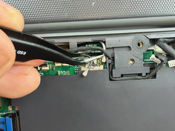

  22. Asus Chromebook Flip C214MA Display Assembly Replacement: step 22, image 1 of 3 Asus Chromebook Flip C214MA Display Assembly Replacement: step 22, image 2 of 3 Asus Chromebook Flip C214MA Display Assembly Replacement: step 22, image 3 of 3
    • Use a prying tool to flip open the locking clip and unplug the world-facing camera and microphone cable from the motherboard.
    • Unplug microphone cable from the motherboard.
    • There may be foam pieces covering the cable, you can use tweezers to pull them off.
