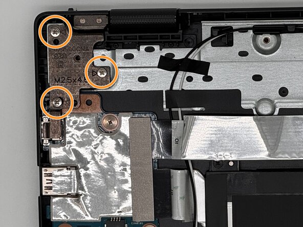

    4. Asus Chromebook CX1500CN Display Assembly Replacement: step 7, image 1 of 3 Asus Chromebook CX1500CN Display Assembly Replacement: step 7, image 2 of 3 Asus Chromebook CX1500CN Display Assembly Replacement: step 7, image 3 of 3
      • Locate the left hinge of the display assembly.
      • Remove the three 5 mm-long screws on the left hinge with a Phillips #1 screwdriver.
