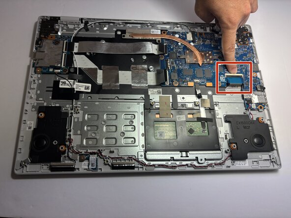

    3. Asus Chromebook CX1500CKA-AS84F Keyboard Replacement: step 8, image 1 of 2 Asus Chromebook CX1500CKA-AS84F Keyboard Replacement: step 8, image 2 of 2
      • Pull the thick blue ribbon cable straight out of its connector to disconnect it from the motherboard.

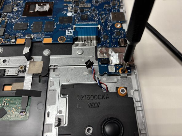

    9. Asus Chromebook CX1500CKA-AS84F Keyboard Replacement: step 14, image 1 of 3 Asus Chromebook CX1500CKA-AS84F Keyboard Replacement: step 14, image 2 of 3 Asus Chromebook CX1500CKA-AS84F Keyboard Replacement: step 14, image 3 of 3
      • Remove the three 2 mm JIS #00 screws from the motherboard.
      • Remove the three 1 mm JIS #00 screws from the motherboard.

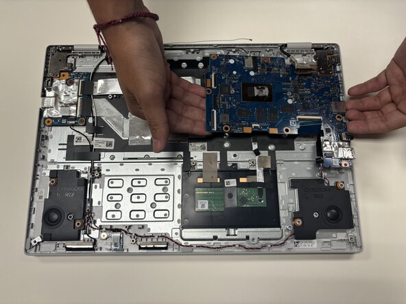

    10. Asus Chromebook CX1500CKA-AS84F Keyboard Replacement: step 15, image 1 of 2 Asus Chromebook CX1500CKA-AS84F Keyboard Replacement: step 15, image 2 of 2
      • Gently lift and remove the motherboard.

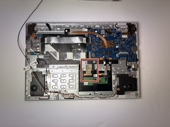

    2. Asus Chromebook CX1500CKA-AS84F Keyboard Replacement: step 17, image 1 of 2 Asus Chromebook CX1500CKA-AS84F Keyboard Replacement: step 17, image 2 of 2
      • Gently remove the tape from the frame.

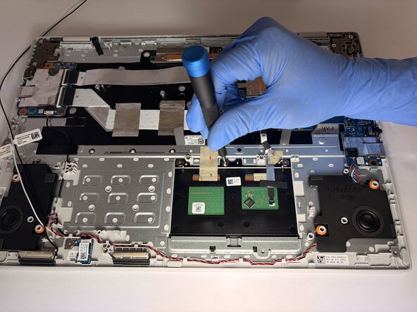

    3. Asus Chromebook CX1500CKA-AS84F Keyboard Replacement: step 18, image 1 of 2 Asus Chromebook CX1500CKA-AS84F Keyboard Replacement: step 18, image 2 of 2
      • Remove the three 2 mm screws using a Phillips #1 screwdriver.
