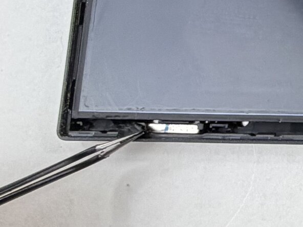

  5. Asus Chromebook C425TA-DH384 Display Replacement: step 5, image 1 of 2 Asus Chromebook C425TA-DH384 Display Replacement: step 5, image 2 of 2
    • Pull the black adhesive on top of the screen.
    • Using tweezers, gently pull the adhesive out, then toward you until it comes out on both side.
    • Lift the screen out.

  6. Asus Chromebook C425TA-DH384 Display Replacement: step 6, image 1 of 3 Asus Chromebook C425TA-DH384 Display Replacement: step 6, image 2 of 3 Asus Chromebook C425TA-DH384 Display Replacement: step 6, image 3 of 3
    • Remove the tape behind the display to thats on the connector.
    • Lift up the locking flap securing the display cable.
    • Disconnect the display cable.
    • Remove the display.
