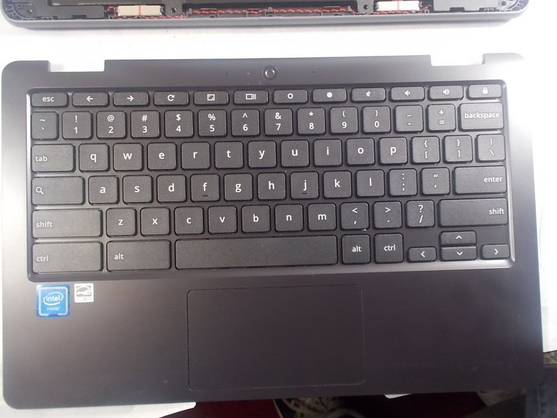

    10. Asus Chromebook C213SA-YS02 Keyboard Replacement: step 10, image 1 of 3 Asus Chromebook C213SA-YS02 Keyboard Replacement: step 10, image 2 of 3 Asus Chromebook C213SA-YS02 Keyboard Replacement: step 10, image 3 of 3
      • Flip the device over and open up the LCD screen.
      • Using the iFixit opening tool, gently place the tool in between the back-plate and the keyboard and lift up.
      • Slide the tool around the outside of the keyboard and lift up the tool while moving it around the boundary of the keyboard.
      • Be careful not to jam the tool deep into keyboard. This could cause damage to the motherboard.
      • Pull the keyboard away from the back-plate. Be careful the keyboard cable is not caught on the back-plate while performing this maneuver.
