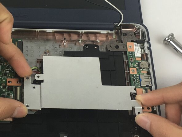

    1. Asus Chromebook C202 Input/Output Board Replacement, Battery: step 4, image 1 of 3 Asus Chromebook C202 Input/Output Board Replacement, Battery: step 4, image 2 of 3 Asus Chromebook C202 Input/Output Board Replacement, Battery: step 4, image 3 of 3
      • Use a spudger or a clean fingernail to flip up the locking flap on each end of the cable—this is the unlocked position.
      • Gently remove the ribbon cable connecting the I/O board to the motherboard.
      Ask FixBot
    2. Asus Chromebook C202 Input/Output Board Replacement: step 5, image 1 of 3 Asus Chromebook C202 Input/Output Board Replacement: step 5, image 2 of 3 Asus Chromebook C202 Input/Output Board Replacement: step 5, image 3 of 3
      • Remove two 4 mm Phillips #1 screws from the metal grate connected to the battery.
      • Remove metal grate from battery.
      • Remove six 4 mm Phillips #1 screws from the battery.
      Ask FixBot
    3. Asus Chromebook C202 Input/Output Board Replacement: step 6, image 1 of 2 Asus Chromebook C202 Input/Output Board Replacement: step 6, image 2 of 2
      • Use the point of a spudger to push on alternating sides of the connector to "walk" it out of its socket and disconnect the battery from the motherboard.
      • It may take a lot of alternating before the connector comes out. Be patient.
      • If that doesn't work, grip all the cables at once as close to the connector as possible and pull the connector slowly and steadily out of its socket.
      • Lift the battery from the bottom edge to to remove it from the Chromebook.
      Ask FixBot
    1. Asus Chromebook C202 Input/Output Board Replacement, Input/Output Board: step 7, image 1 of 2 Asus Chromebook C202 Input/Output Board Replacement, Input/Output Board: step 7, image 2 of 2
      • Remove two 4 mm Phillips #1 screws connecting the I/O board to your Chromebook.
      • Slide the I/O board out from the edge of your Chromebook.
      Ask FixBot
